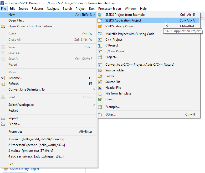

jiri_kral
what type is your project - it is S32DS example or you create new project from scratch?
Typically such kind of error occurs if you create new C/C++ project instead of New S32DS Application Project:
Jiri
