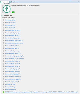

partis
When using S32 Design Studio and adding the FreeRTOS component, it allows configuration of the various sections of FreeRTOS. When changes are made to the design via the GUI, the file peripherals_freertos_1.c is updated with comments of new settings, but FreeRTOSConfig.h does not change with the actual settings.
Is this a known problem?

partis
Hello Mike
Digging through the .mex file, I find that the IDE is placing the FreeRTOSConfig.h file elsewhere. It has detected another version of this file in a virtual folder within the project, and has decided to use that instead of the "board" folder.
The image above shows what the IDE is updating and relative paths. Obviously, the last entry is incorrect (it is picking up demo code from a CANopen stack). Manually changing the .mex file has no effect as it appears to re-search the filesystem and pick up the first entry it finds (presumably in alphabetic order).
Is there a way to prevent this automatic search-and-change from taking place?
Kind regards
Gary

partis
Hi Mike
I have created a work around for the IDE placing the FreeRTOSConfig.h file in the incorrect place. Before starting S32 DS, manually edit the .project file such that the virtual directory points to an illegal path, so the tool doesnt find an alternative FreeRTOSConfig.h file to update. Then perform all configs, regenerate files; and exit S32 DS. Finally, manually edit .project back to the true path.
This work around is satisfactory for our needs
Just need to sort the clock tree now...
