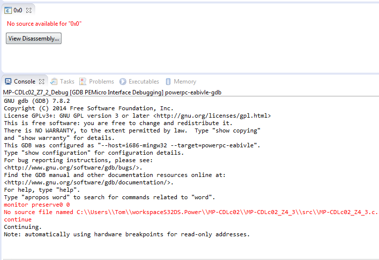

I'm flashing an MPC5777M on on own board design for the first time and seeing the pop up window below each time.
Is this a sign that I have something wrong on the board or another issue? I'm seeing this after entering debug from S32 Design Studio. I'm using a PE Multilink Universal to interface. Once I cycle power it SEEMS to finish flashing, but then I get another error shown below. I'm not sure if the issues are related or separate.

After adding the external power I seem to be getting the reset escalation error less often, but I seem to be getting several different other errors seemingly random. I've included screen shots of the errors I'm getting. Sometimes they occur and sometimes they don't. I am pretty sure I have not been able to actually get my program to run at all. I thought I was starting off simple by just setting up a single pad, T15, to toggle. The associated SIUL register never changes from default even though I have the line:
SIUL2_MSCR_IO_288 = 0x12380000;/* Set PT15 to GPIO */
I'd appreciate any help in getting pointed in the right direction.

I am starting to be little bit helpless. I have consulted this issue with my colleague and it seems it could be some hardware problem. Because we do not have your hardware, we are not able to replicate the issue to investigate it deeper. Are you able to use NXP EVB? Do you have any other debugger (for example Lauterbach)? This could exclude or confirm hardware problem.
