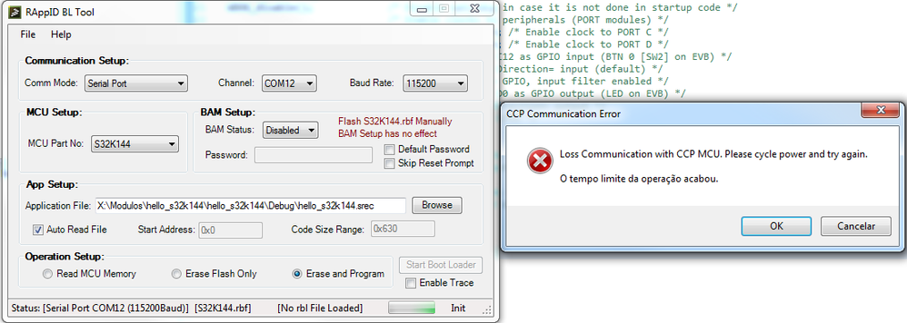

lohrsistemas
I tried this but the below error occurs:
2,331 Views
jiri_kral
did you successfully upload the bootloader firmware itself into EVB? (the .rbf file). You can copy it into openSDA mass storage or upload it as normal .srec file.
