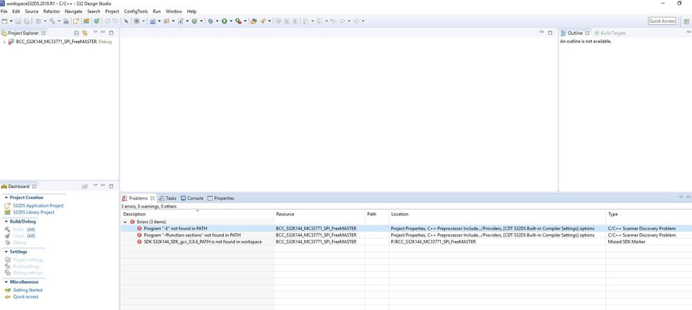

Program "-E" not found in PATH

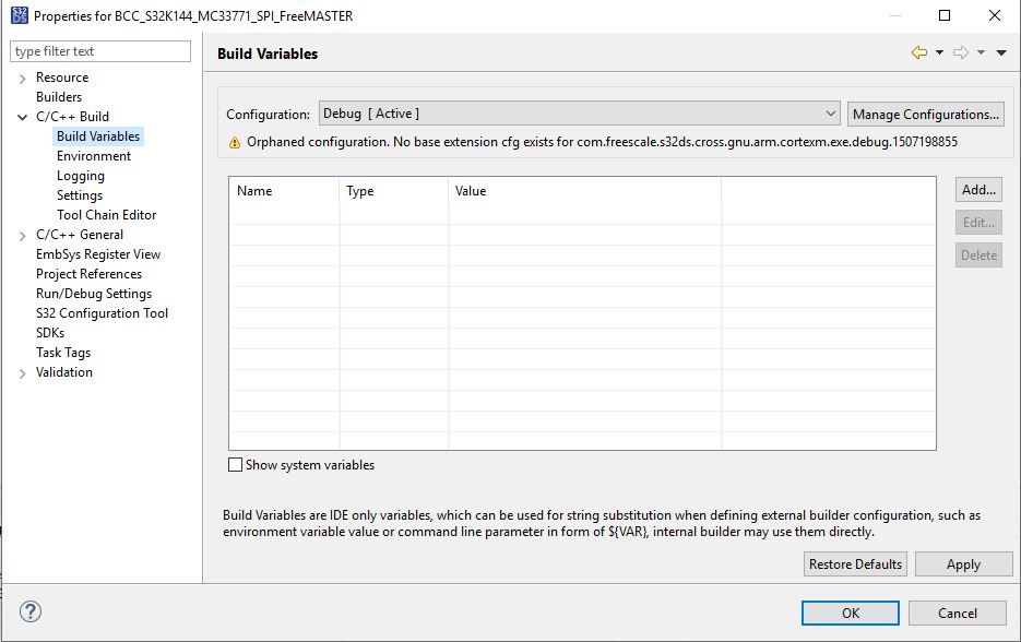

I uninstalled and then installed a newer version of S32DS, and I am not able to debug the project.
I also have this message:
Orphaned configuration. No base extension cfg exists for com.freescale.s32ds.cross.gnu.arm.cortexm.exe.debug.1507198855
SW version: 2018.R1
I am trying to run the BCC_S32K144_MC33771_SPI_FreeMASTER example.

The message indicates that you have your project configured for a toolchain (or toolchain integration) which does not exist any more.
Does it happen as well for a new project or is this an existing project?

This is an existing project.
I tried the following but didn't solve the problem:
1 - Deleted the project (and all its contents on disk).
2- Downloaded the project again from NXP website
3- Imported the project as a new project.
This didn't solve the problem tho!

Does it happen as well for a new project you create with the wizard?
That 'orphaned' message says that you have a project using the build plugin com.freescale.s32ds.cross.gnu.cortexm.... but you don't have that plugin installed.

1091818158
Yes, I installed the latest updates.
But I did not run this demo, but a project my company made before.
I found that it worked okay when I deleted the project and recovered it from a backup zip.
So I guess the error was because S32DS v3.3 damaged the project files generated by S32DS v2.0.
