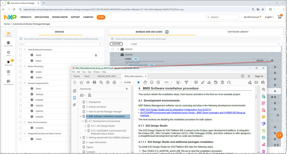

Hi Philipp,
Sorry, I checked the latest HVBMS for the S32K358 and it still uses S32DS v3.5 and RTD 3.0.0.
At this stage, I'm afraid you'll have to refer to section 4 BMS Software installation procedure in the BMS_SWInstalationGuide_Bring-up_2024.10.pdf to install these software.
BMS_SWInstalationGuide_Bring-up_2024.10.pngBMS_SWInstalationGuide_Bring-up_2024.10.png
It is not recommended to install these software in S32DS v3.6.3. Unless the HVBMS team releases a new version of the software package, those examples will not work in S32DS v3.6.3 + RTD 6.0.0 environment.

PhilippH
we managed to install a working environment with the detailled installation guide and downgraded our project.
Despite using the S32K358, some of us develop on EvalBoards using the S32K396 (https://www.nxp.com/part/S32K396BMS-EVB).
I tried installing the S32K396 SDK in my environment, however S32DS now crashes upon opening it. Is there a way to use the HVBMS environment with S32K396?
3,298件の閲覧回数
Robin_Shen
I noticed that the two packages are different in the Automotive Software Package Manager.
I recommend reinstalling S32DS v3.5 in a different directory, such as C:\NXP\S32DS.3.5_S32K396BMS.
