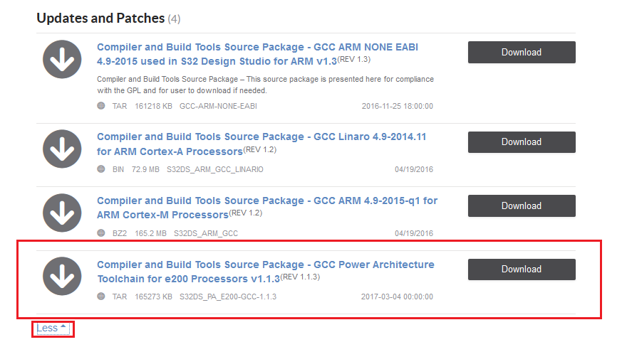

martin_kovar
Hello Ludwig,
please click link below and there is toolchain for GCC power architecture:
S32 Design Studio IDE|NXP
Martin
17,959 Views
bastian_schick
You should add: "Click <More>" to see it.
17,959 Views
