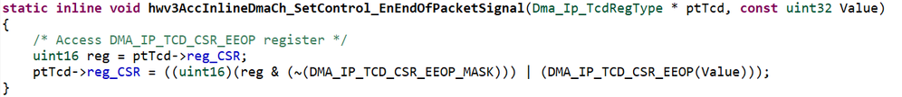

Dear NXP Family
Below is my configuration
I was going through Dma configuration tool as shown below and noticed a setting "Enable End Of Packet Signal"
The code corresponding to this set bit 6 of TCDn_CSR register as shown below
But the same bit is reserved in the reference manual of S32K3xx as shown below
Am i missing anything?

Thanks for your feedback.
This bit might have been defined for proofing the feature on the K3 platform, but ultimately the bit might have been deprecated under the documentation. We will confirm this situation to verify why the bit is still being referenced under the code but not under the documentation.

We apologize for the delay.
It seems that it is a bug under the RTD. We have escalated this situation to the related team for them to analyze this situation.
Since this might take more than the expected time of resolution, we might not be able to answer inside this same thread. We do apologize.

Thanks for the message. Its clear that the reference manual is uptodate.
