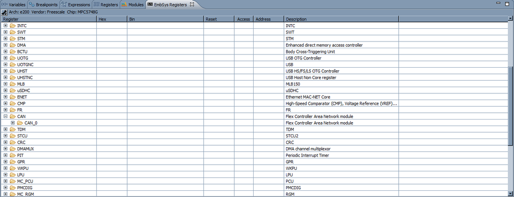

Only CAN_0 in S32DS Debug view
2,680 Views
bdn
why is there only CAN_0 in S32_Debug view as seen on the screenshot?
I'm using S32DS for PowerPC in verison 1.0 with MPC5748G Eval Board and 176QFP Daughtercard.

bdn
this issue is _not_ fixed in S32 DS for Power Architecture 1.1.

Hi Bernhard,
I checked the issue and you are correct, there is only CAN_0. It seems it is a bug, so I reported it immediately. Sorry for inconvenience, I hope it will be fix in the next release, which should be available at the end of June.
As a workaround, memory view could be used.
