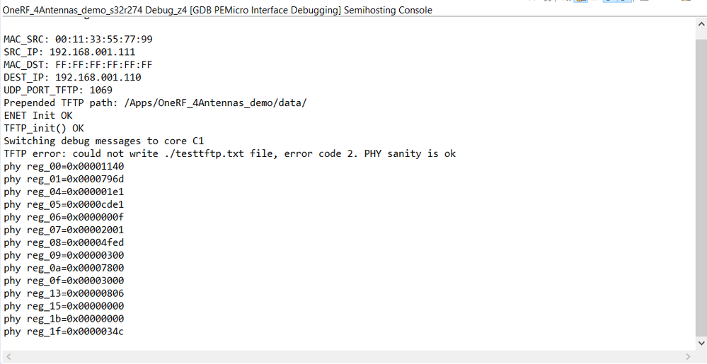

Hello
I am trying to use this library which is OneRF_4 Antennas demo example. But I got error attached in below. How can I solve this problem ? I am using version 2.1 S32DS IDE. Thanks in advance

jiri_kral
may be a stupid question - isn't the testtftp.txt file opened with other application and write into file is blocked?

Paroz
Yes, may be. Actually I couldn't even find this txt file. How can I check if it was opened by another application?

jiri_kral
did you properly setup tftp server?
S32R274
  • Setup TFTP server:
    • set IP host PC to 192.168.1.110
    • configure TFTP server (edit OpenTFTPServer.ini file):
      • listen on 192.168.1.110 : 1069
      • home directory - < rSDK_folder >/
    • open CMD console and cd to server app folder (default C:/OpenTftpServer/)
    • start running server (OpenTftpServer.exe -v)
  • Run PC visualizer app:
    • open CMD console and set working directory in < rSDK_folder > /Apps/1RF_4Antennas_demo/matlab/
    • RunRadarApp.exe with argument "s32r274"
You can find full Example documentation (with default install path) in c:\NXP\S32DS_Power_v2.1\S32DS\software\S32_SDK_S32PA_RTM_3.0.3\middleware\rsdk\Docs\RSDK_User_Manual\  folder.
