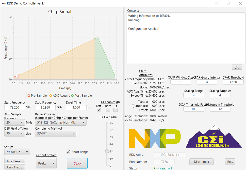

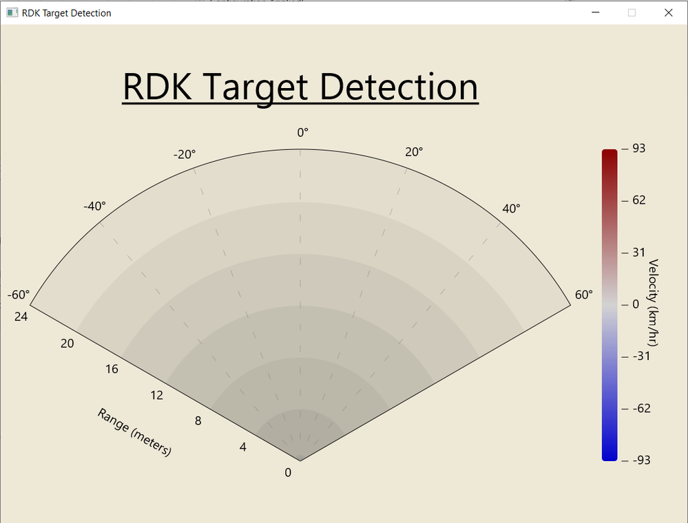

Hello everyone,
I'm trying to make an SDK DEMO example but I can't see anything in the Radar Demo Controller Guide. As you can see in picture successfully connecting but it doesn't see any target.

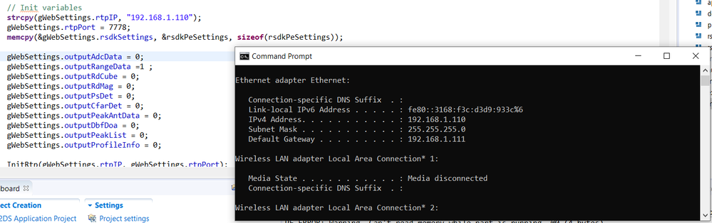

- I checked the IP adress and follow to instructions in FIRST_Quick Start Guide for RDKS32R274
- I thought that may be  it causes from Defender Firewall so I disabled the firewall.

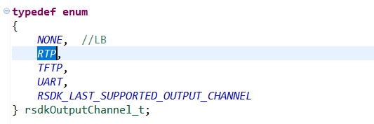

I want to be sure so I am asking, which one Do I have to select for successfully connection between S32DS and RDK
I tried the all options but I didn't obtain affirmative result. How can I solve this problem ? If you give suggesiton or idea no doubt I am glad.

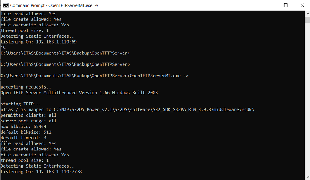

Btw I see the ethernet light blinking when debugging the code
Output ;
