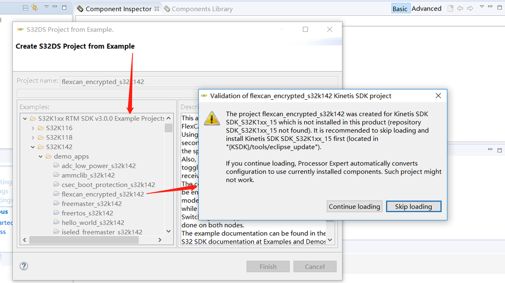

      I have installed SDK_S32K1xx_RTM_V3.0.0 in S32DS, then I wanted to create a new project from example, but failed.
      Thus is the screenshot for the error.
       How can I solve the problem?

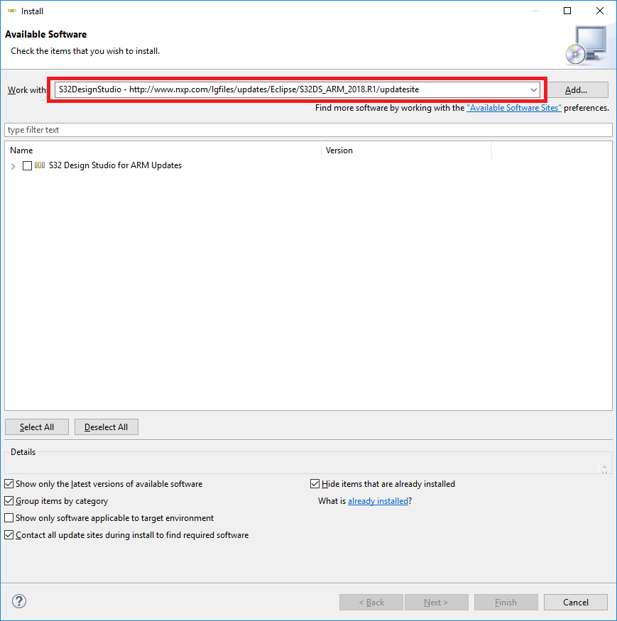

What method did you use to install the SDK_S32K1xx_RTM_V3.0.0?
Did you install within the tool from S32DesignStudio - http://www.nxp.com/lgfiles/updates/Eclipse/S32DS_ARM_2018.R1/updatesite ?

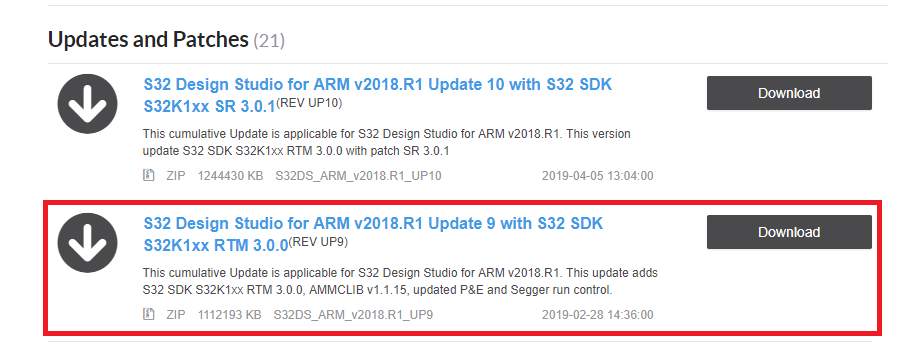

Or did you download the Update 9 package from the S32DS for Power product page and then install?
If you did not use one of these methods, then there is a chance that the install did not occur correctly.
Also, please note that there is a new update, Update 10 which contains a patch to the SDK,  S32 SDK S32K1xx RTM 3.0.1. Please see this notice: https://community.nxp.com/docs/DOC-343020 . It is possible the problem you are reporting was corrected in this patch.

Please ensure you have installed all of Update 10 and then try again. Since it is a cumulative update, I contains all of the previous updates. It is possible you missed an update which would avoid this issue. Some changes were made in the past to the installation layout including the installation location of the SDKs which could cause this error message if not all of the updates have been installed.
Did you selectively choose this SDK from the overall list of Update 9 items?
I have tried this example project on my end and I am unable to reproduce the issue. It works perfectly.
