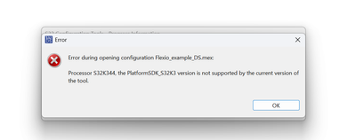

Not able to open the project getting error
2,033件の閲覧回数
annappa
getting this error, pls let me know how to resolve

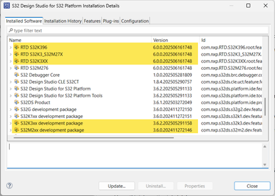

annappa
Please find the installation detials

_Leo_
Hi again,
Those are not the "Installation Details". Please double check you have installed the following SW:
On the other hand, for development with S32K3 series we recommend to use the latest S32DS and RTD versions:
• S32 Design Studio 3.6.4 – Windows/Linux
• S32K3_S32M27x Real-Time Drivers ASR R21-11 Version 6.0.0
To download IDE, go to S32 Design Studio for S32 Platform page -> Downloads ->
To download RTD, go to S32K3 page -> Design Resources -> Software-> S32K3 Standard Software -> Automotive SW - S32K3/S32M27x - Real-Time Drivers for Cortex-M
Please check before Release Notes for installation flow/details to each SW.
Once you have installed SW, you could refer to various examples.
I hope this information is helpful.

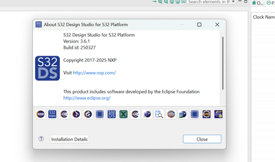

annappa
I am using the below version
S32DS_3.6.1_RFP_win32.x86_64
1,989件の閲覧回数
_Leo_
Thank you for your interest in our products and for contributing to our community.
Please screenshots of your "Installation Details", which you can find in "Help" tab of the IDE.
