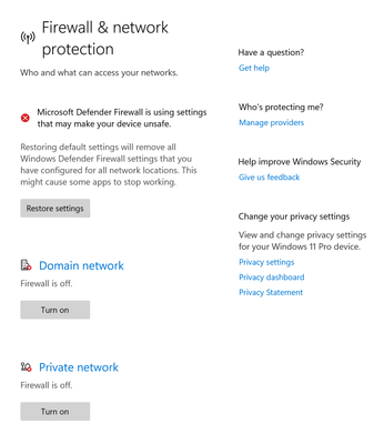

After failing to get S32DS for Arm to work on my new Windows 11 machine, I am transitioning to S32DS for S32 Platform. When I create a new "S32DS Application Project" there are no processors available.
I also look into updating SDKs, and nothing is available. I even downloaded the S32SDK_S32K1xx_RTM_4.0.3.exe.
I've also deactivated the windows defender firewall. This is a fresh install with S32DS being the first install.

I have downloaded everything I can:
It is somehow not getting all of the packages. I am having issues with several NXP packages. I have a fresh Windows 11 install now on a home network. I have turned off all windows firewalls. Even the "allow an app through a firewall", so I can't imagine it's a firewall issue at this point.
