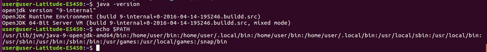

Hello everyone:
   I met a problem while installing the  S32 design studio for arm. I was prompted that: No Java virtual machine could be found from your PATH environment variable.  You must install a  VM prior to running this program. But i have installed the openjdk-9-jdk, and it can be found in PATH.
   I don't know how to deal with it, can you help me? Thank you!
3,518 Views
jiri_kral
S32DS Installation requires Java v1.8. OpenJDK 8 is also okay. Just install OpenJDK 8 should solve your issue.
