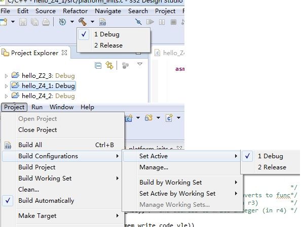

I download S32DS_Power_Win32_v1.2_b170613 at 2017/7/21.
I can`t Debug a Project from RAM because i have no Debug_RAM  option.
Here is the pic.
Someone who can help me ?

It seems you created a new project for MPC5748G from an example.
Some examples does not include Debug_RAM build configuration.
I'd recommend you either to create a new bare board project and copy the source files.
Or create a new "Debug_RAM" Build Configuration (you will have to add a RAM .ld liker file) as suggested above.

xd_pang
Hello
You are exactly right, i created a new project for MPC5748G from an example.
After I create a new bare board project , I can Debug_RAM now.
About creating a new "Debug_RAM" Build Configuration ,I will try that later.
Thanks for the help.
