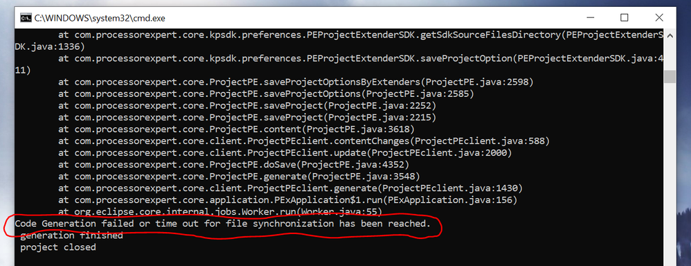

amarjeet_kumar
Hi Styger
I followed your suggestion from your last reply,but still my problem not solved.
I have created S32 Design studio Project by selecting IAR Toolchan for ARM(8.x) with SDK (S32SDK_S32K1xx_RTM_3.0.0 ) and when i am trying to generate the code from Processor Expert using command line i am facing below error.
Command used : eclipsec.exe -noSplash -data c:\Users\XYZ\workspace -application com.freescale.processorexpert.core.PExApplication -generate projectABC
i am also attaching the error log file here.
If you want i can share the Basic project along with script batch file.
Please help in solving this issue.
Amarjeet

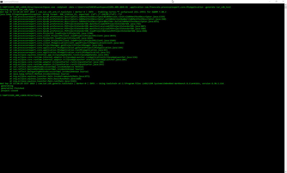

jiri_kral
in attachment is my testing project. PE Code can be generated from command line without any issue using this command:
eclipsec.exe -noSplash -data c:\Users\nxf24838\workspaceS32DS.ARM.2018.R1 -application com.freescale.processorexpert.core.PExApplication -generate iar_sdk_test
Here is console output:
It is possible share your project?
