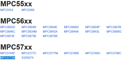

I'm looking at the suggested links from the MPC5775E-EVB pages and looking for examples. When I get to the Examples page, there are no examples for the MPC5775E. The closest is the 5775K. Is this an error or are there just no examples for the 5775E?

lukaszadrapa
yes, there are no examples for MPC5775E on that page. The closest alternative for MPC5775E is MPC5777C and you can use examples for MPC5777C.
If you want to use SDK in S32 Design Studio, you can also check examples for MPC5777C. When you create new application project, it offers to use SDK - and it's SDK for MPC5777C which is compatible with MPC5775E.
