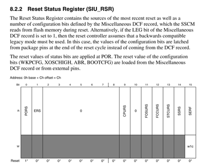

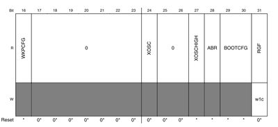

You can read reset source from SIU_RSR

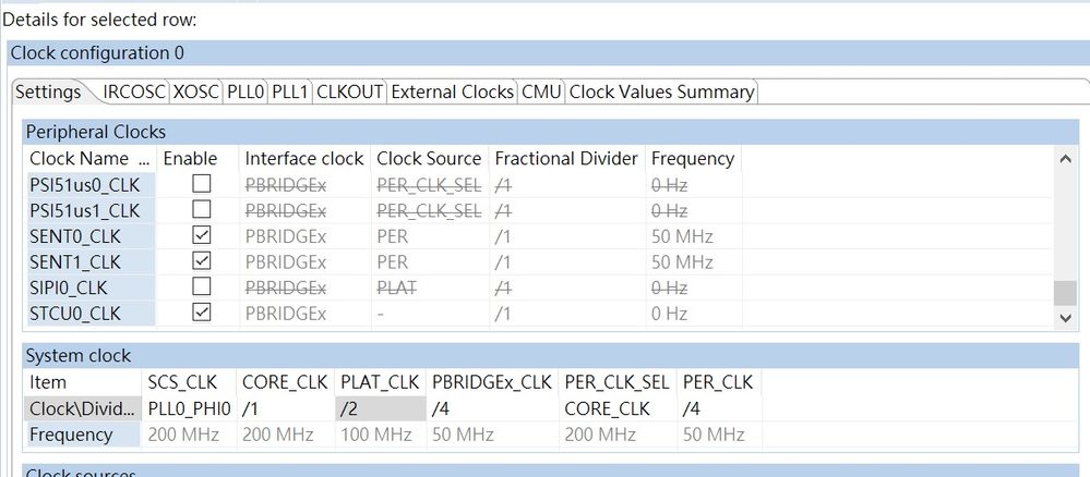

    Thanks for your help. I found the issue but I don't know hoe to fix it. The clock of STCU0_CLK is 0 Hz even I enabled it the component inspector page.STCU_CLK.jpg
 CRC0_CLK has same problem. When I tried to access the register It will caused system reset.
 Reset is from FCCU (FCCUURS). How to turn on the sys clock for STCU.
Mark
I am not familiar with these configuration tools. But I do know very well how STCU works on system level.

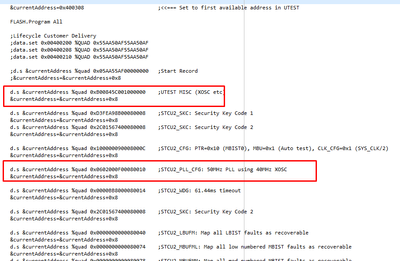

What you are writing is not correct. STCU clock is active even during reset phase (as STCU performs BISTs and writes the results to the STCU registers). So reading results is possible right after reset is released by any requesting master.
It is on, by default. In fact you are configuring it in your DCFs.
I have attached for reference DCF programming script with setting to execute offline BIST at 50MHz.

    I enable the STCU clock and regenerate Processor Expert code again then success to run online BIST.
however, I checked  my offline BIST result  : STCU->LBS , MBSL value is all 0.
How can I check  offline BIST has run or not ? maybe some thing wrong with my DCF recode?

To see what caused your system reset you can read RGM DES/FES registers.
