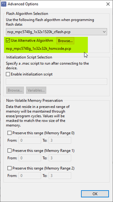

I previously flash a code which chose F8C000h as boot header.
However, I wanted to change the boot header to FA0000h, so I flash another code with boot header in FA0000h.
I expect F8C000h address will first be cleared automatically when I use multilink JTAG to burn code, but the result is I got 005A in the first half word in both F8C000h and FA0000h.
How to earse the boot header in F8C000h?
thanks

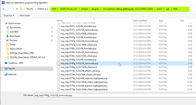

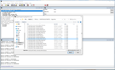

unfortunately PEMicro plugin for S32DS is not able perform erase only. You can use PE Micro PPCNEXUS software which can be download on PE Micro pages.
For erasing the 0xF8C000 memory space you need to select nxp_mpc5748g_1x32x32k_hsmcode.pcp programing algorithm.
Other possibility is using this workaround -
https://community.nxp.com/t5/S32-Design-Studio-Knowledge-Base/HOWTO-MPC5777C-Low-Mid-Flash-block-era...
add use the same algorithm:

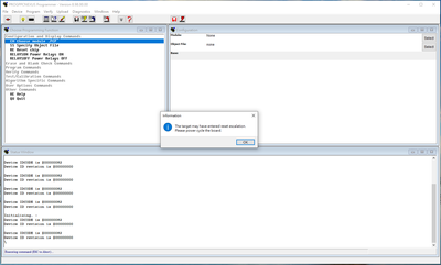

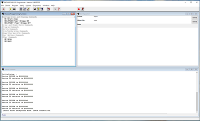

For the PE Micro PPCNEXUS software, I got this error
and cannot connect MPC5748G to PE Micro PPCNEXUS.

jiri_kral
The powercycle of board works, but you need to have external power supply if you are using integrated OpenSDA debugger. Powercycle the board together with clicking on OK button. You need to be quick.

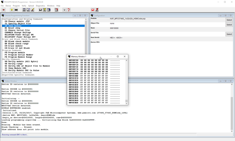

No, click on OK button on Reset Escalation message. I just test it on my side (I was able bring my board to the state as your is) - after board reset is reset Red diode lighting and I have some A5 value and some garbage on 0xF8C0000. With PPCNEXUS SW I was able recover it.
I simply simultaneously switched power and click on OK button. After that I erased flash memory.

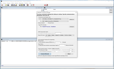

junehsiao

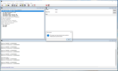

After I encounter this error message:
I turn off the power of the board.
And then simultaneously turn on the power and press "OK" button.
Then I got this:
It seems like hasn't been connected yet.
Do you know why?

jiri_kral
First step is connect to board - after connect - the Reset Message appears.

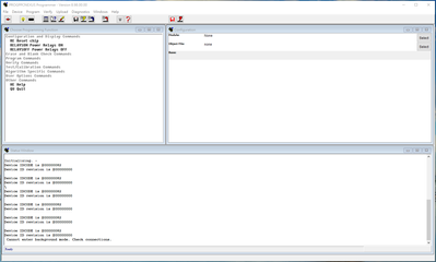

junehsiao
Yes, I did connect to the board first.

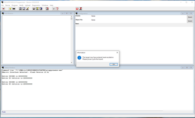

These are my steps:
1. Press connect
2. Got this message
3. Power off the board. Then simultaneously power on the board and click OK.
4. This window shows:
I choose NXP_MPC5748G_1x32x32k_HSMCode.pcp
5. This message pops up again:
6. Power off the board. Then simultaneously power on the board and click OK, again.
7. Result:

jiri_kral
Well, keep trying - it is little bit tricky. On my side after power on - there is little delay before the Red LED starts lighting. You need to fit pressing the OK button exactly in this time - after power on and before Red LED starts light.
