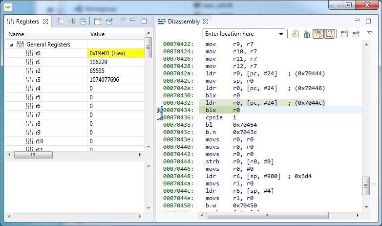

I'm trying to develop a way to update the boot-loader application on my S32. To do this, I'm trying to copy the "old" boot-loader to a new location in flash, and jump to it. After running the "old" boot-loader in the new location, the idea is that it will erase the old location and flash the *new* boot-loader.
I've also seen this done where there are always two boot-loaders, one new and one old, in two different locations. However, the problem I'm having exists for both scenarios:
After jumping to the old binary in the new location (0x70000 rather than 0x10000), there are inevitably address for functions that get jumped to explicitly. The following example is from the startup code (although this happens elsewhere in text.main if I skip startup), where the CPU is jumping to an address 0x19E01 as indicated in the binary file that used to be at 0x10000.Program Relocation Issue.jpg
How can I compile this program so that subroutines that used to run at 0x19E01 will now just run at 0x79E01?

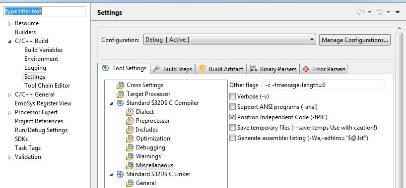

Minor Update:
It looks like the actual term for this is "position independent code" - however when I enable this option, I get linker errors for the  ".got" section overlapping with .code. Any hints on how to edit the linker script to properly place these new sections?

Still messing with this - albeit blindly. It occurred to me that even though I have "-fpic" set in my compiler settings, I don't have any such setting in my linker. I added "--pic-executable" to the linker's options, which generated sections for "interp", "dyn", "rel.dyn" and "hash". I tried throwing these into the data section as well, but got the following error:
c:/nxp/s32ds_arm_v2.0/cross_tools/gcc-arm-none-eabi-4_9/bin/../lib/gcc/arm-none-eabi/4.9.3/../../../../arm-none-eabi/bin/ld.exe:  could not find output section .hash
c:/nxp/s32ds_arm_v2.0/cross_tools/gcc-arm-none-eabi-4_9/bin/../lib/gcc/arm-none-eabi/4.9.3/../../../../arm-none-eabi/bin/ld.exe: final link failed: Nonrepresentable section on output
I'm guessing this is because even though the compiler has been given "-fPIC", it isn't generating a .hash section expected by the linker?

jiri_kral
there is no special settings needed for position independent code. The .got section is created automatically.  When you enable -fPIC option, the absolute addresses are converted to offsets. In attachment is objdump for hello_world_clocks examples without and with -fPIC options.
