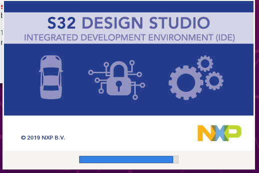

I am trying to install S32 power-pc (S32DS_Power_Linux_v2.1.bin) on ubuntu. I have followed the instructions here
First I tried to install it using the -i console option, but that did not work.....
I was forced to install ubuntu-desktop unfortunately. Now I am stuck.
The problem is that the install wizard is never popping up. Only the first window:
So it will freeze here forever. Any suggestions?

I never get that far and no log is created. I just get to the indefinite popup. I do not have any NXP folder in home. This is my console:
devops01@bygg05:~/Download$ ./S32DS_Power_Linux_v2.1.bin
Preparing to install
Extracting the installation resources from the installer archive...
Configuring the installer for this system's environment...
Launching installer...

jiri_kral
Well - please make sure that you install all additional packages required for Linux host - you can find it in installation guide - https://nxp.flexnetoperations.com/control/frse/download?agree=Accept&element=10944607
It is possible that not all required 32 bit packages are present on your machine.

Bananajoe
Yes, I followed that guide. Everything went well except I remember I had some problems with libwebkitgtk-1.0-0 since this version is not included for Ubuntu 20.04, only libwebkitgtk 2.x.x is included. But I managed to get it manually. Perhaps this is the problem?
Maybe the S32DS is not compatible with Ubuntu 20.04 ? Have you tested installing it on this version of Ubuntu ?

mikedoidge
Hi Mathias,
The S32DS 3.4 does not support Ubuntu 20.04, though we do have plans to add this support in the future.
You can find a list of the supported OS versions in the S32DS_Release_Notes.pdf, which is located on the website where you downloaded the installation file and as well once S32DS is installed in the folder: {Installation Path}\Release_Notes\
