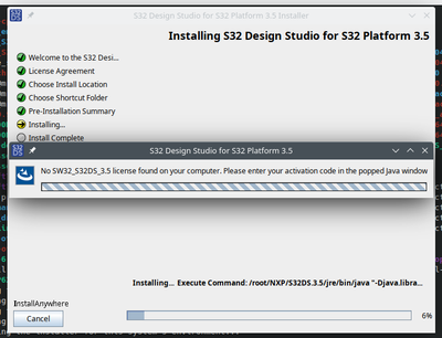

I have tried to install S32DS on a Ubuntu 22.04 for the first time.
I think I have enter a wrong Activation Key. After cancel the installation process and restart the process stuck at 6% Check License.
I have trey to restart the installation process but I don't get the window to enter my key
What could I do?
Thanks for your help.

You might try to re-initialize the trusted storage by deleting:
/usr/local/share/macrovision/storage
Mike

Hello.
Thanks for this hint.
After deleting macrovision I get the possibility to enter a new code.
But my installation stuck at 6%.
What could cause this problem?

My installation stuck all the time on 6%.
What could I do to find the problem?
