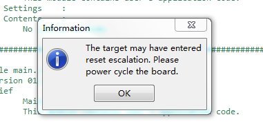

Hi there:
I bought a S32R274RRUEVB daughter board and MPC57XXXMB mother board and tried to debug them with a PEMicro debugger.It is the first time I use them.
But when I plugged the daughter board to the mother board and turned the power switch on,I found the RESET LED D2 was always on no matter how many times I  pressed the reset switch on the daughter board.Then if I tried to debug the example included in S32DS,an error like this pop-up.
Did I miss anything or do anything wrong about this?I'm looking forward to your advice.Thank you!

what about power cycling the board - it doesn't help? Sometimes you need to be very fast - turn OFF power, turn it ON and almost instantly click on retry button on debugger connection error message.
Hope it helps.
