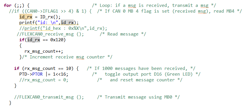

My try is the following:
- open an example from Design Studio: FLEX CAN
- and I have modified in the following way the main.c, FlexCan.c; and FlexCan.h :

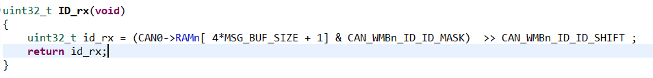

   1)main.c:
 2)FlexCan.c:
3)in the FlexCan.h I just inserted the command line uint32_t ID_rx(void);
My idea is to save only the id of the currently received message in a variable (which clearly change any time that one new message arrives) and as a starting point I just want to print and after a control (in which I simply increment a counter variable to decide when turn on the green led).
I have tried to built and no problems occur but when I try the debug_ram procedure (clicking play button) i notice that on the console the printed id is always "0x0".
I also noticed that the led turn on when a click plays in the debug procedure, but this is strange because also if the reader id is wrong, the "if" condition is not satisfied.
Intuitively I understand that the FlexCan_init function must be modified but I do not know how in order to read any message received.
If someone can explain also the various function in order to understand how modify if I want to not only receive all possible can message, but also if I want to transmit a specific id with a specific periodicity

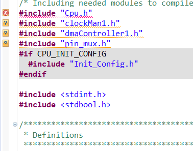

The only problem is that I can't even compile it because the libraries are not linked.
do I have to make any particular settings?
Thanks again in advance for your patience.
Best regards.
3,002 Views
lukaszadrapa
did you click on Project -> Generate Processor Expert Code? Or there's an icon in Components window. This could be the reason...
Lukas

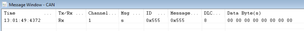

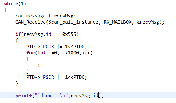

I try to read the message-id using the can_pal example, but there is something I do not understand.
Basically, with the function CAN_Receive(&can_pal1_instance, RX_MAILBOX, &recvMsg), the current message received from the NXP should be saved in the previously initialized can_structure recvMsg. Should be easy to access to the id with the classic "structure_name.field_name".
I modified the main as follows, maintaining the init functions of the can:
I just want to read the message-id and check if is equal to the only one on the bus (an Arduino send a message with id=0x55).
I am sure that the Arduino sends the message because I can check with a peak device on bus master SW.
For sure I doing something wrong but I do not understand what.
Others strange things are that when I do the debug procedure, the white led turn on (??) and that on the console I see this message:
Thanks again for your help.

pierpaolo_dini
Hi Lukas,
Actually I did not select "Generate Processor Expert Code". Now I can build the program.
Really thanks for your support in my trivial problem XD.
Best Regards.
