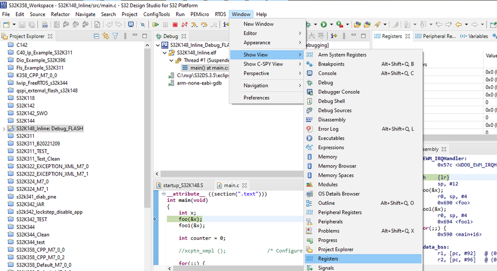

I am currently trying to debug on the S32k144EVB board using the S32 Design Studio for S32 Platform 3.4. I've encountered a unique issue where only the ARM registers are not visible while the other Peripheral registers are visible as expected. I've tried using both the Debugger SDA and Multilink FX to resolve this issue, but without any success. Could you suggest any potential solutions to this problem?
Thank you.

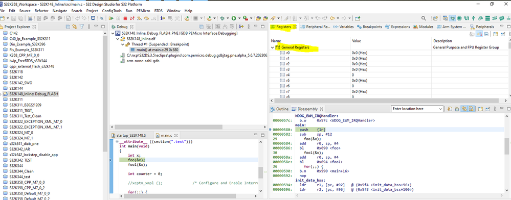

Hi dylee,
The ARM Core registers are shown in the "Registers" view.
To enable it, please see below:
