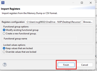

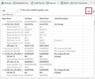

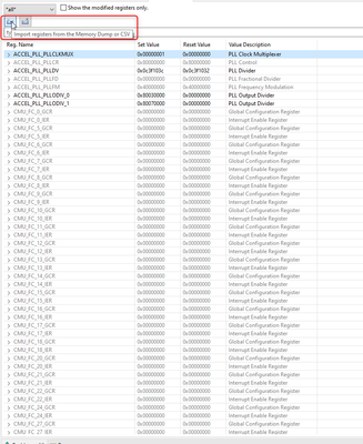

After exporting to a CSV file, you should be able to import by clicking the import button you show in the image and then selecting the file you exported erlier:
Press the import button:
Press the "Browse..." button and search for your file
Select the file you have exported previously:
Once selected click finish:
You will see the modified values highlighted in yellow:
Let me know if you can follow the steps described above or if you encounter any error.
