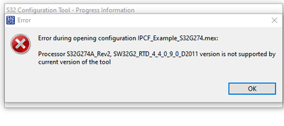

I am trying to build IPCF in S32 Design studio v3.3, but I am getting errors in the process.
IPCF Version: v1.1
S32Design Studio version: v3.3
When I try to update the code by right-clicking the .mex file I get this error:
Any help would be appreciated.

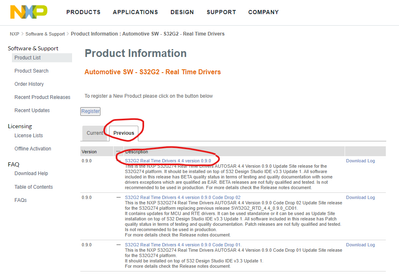

I was able to complete this step without issue. Do you have the SW32G2_RTD_4_4_0_9_0_D2011 installed?
If you do not have this package, you should download and install it.
Please note, the RTD team has since released newer versions so you will need to locate it from the 'Previous' tab.
It seems the IPCF package was developed for and tested to this version, so some adjustments may need to be implemented for it to work with a newer version of the RTD.

Somasundaram_Vadivelu
Thanks for the reply. I downloaded and installed SW32G2_RTD_4_4_0_9_0_D2011, and I was able to update the code . There is one more issue popping now when I build the code:

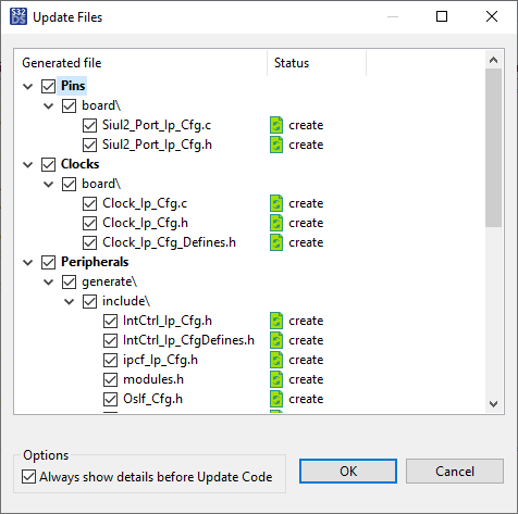

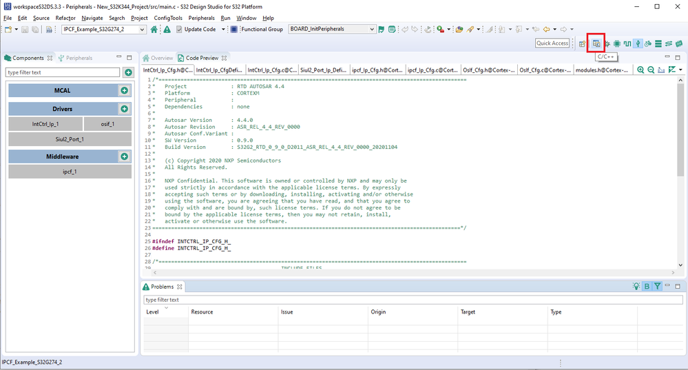

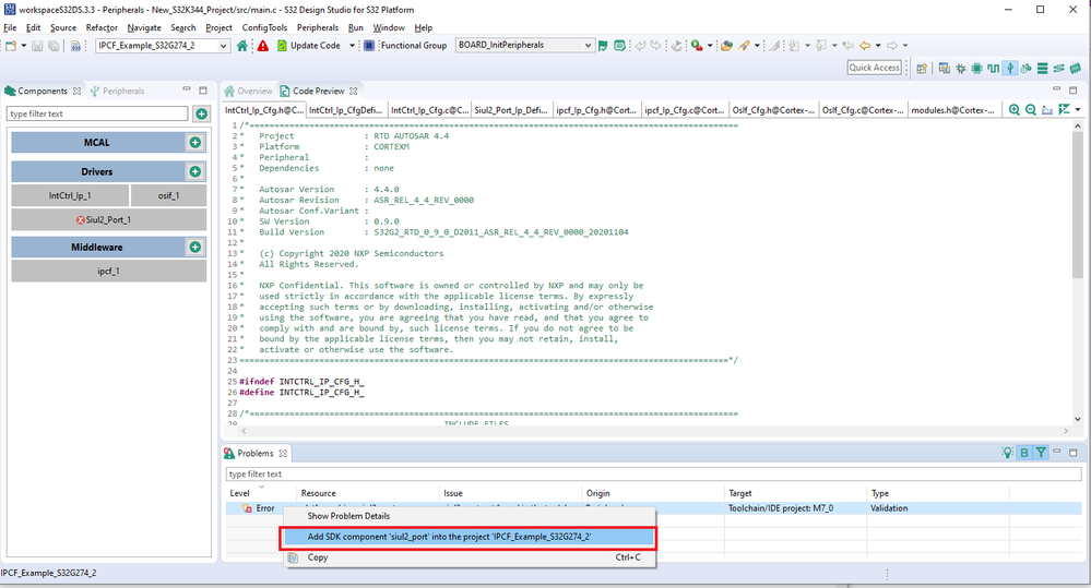

mikedoidge
Hello @Somasundaram_Vadivelu ,

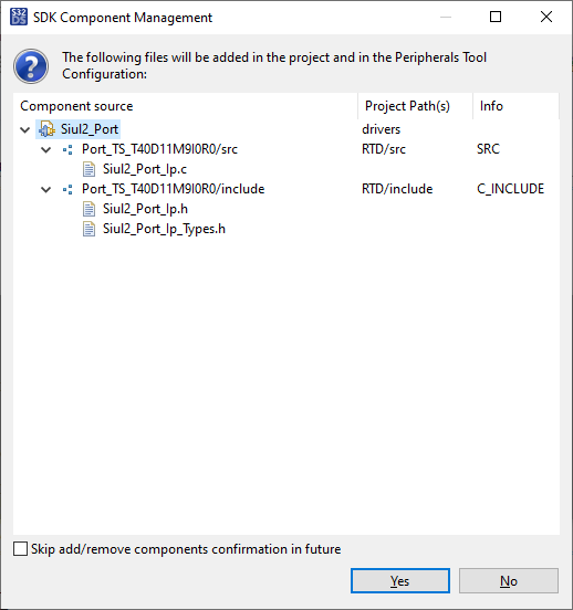

I have found the cause of your issue. You need to complete the S32 Config Tools setup and generate the code.

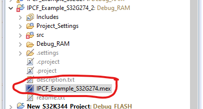

1) Double-click on the IPCF_Example_S32G274.mex file in the Project Explorer:

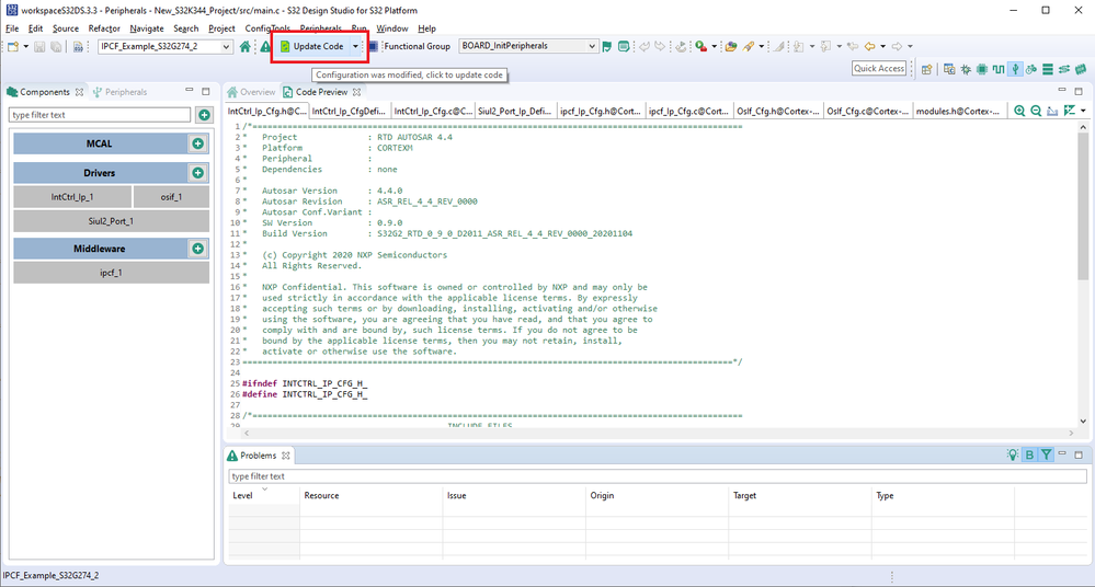

2) Switch to the 'Peripherals Tool' perspective:
3) Right-click on the error listed in the 'Problems' view and select 'Add SDK Component...':
4) Click Yes
5) Click 'Update Code'
6) Click OK
7) Switch back to 'C/C++' perspective and then Build.
The errors should be gone and the ELF file should be created.

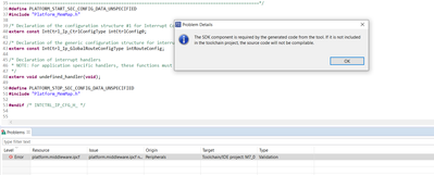

I tried as you mentioned, but I get this issue (When I  right-click the problem, I don't get the " Add SDK component" option
Any clue about this issue? Thanks

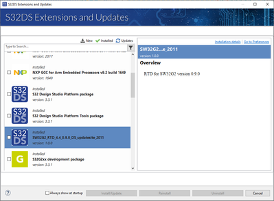

It seems that something is missing. Could you please provide the details of the packages you have installed by doing the following?
1) Help -> S32DS Extensions and Updates
2) Installation details
3) copy and paste the details shown to this thread
I should be able to see if something is missing or maybe you missed some update.
Mike

Sure here is the information you asked:
Package: S32SDK for S32G2xx Rev2 RTD 0.9.0; Version: 0.9.0; Build id: 202008260955
Package: SW32G2_RTD_4.4_0.9.0_DS_updatesite_2011; Version: 1.0.0; Build id: 202011060838
Package: S32 Design Studio Platform Tools package; Version: 3.3.1; Build id: 202008252001
Package: S32G2xx development package; Version: 3.3.1; Build id: 202008252013
Package: S32SDK S32G274 BETA 0.9.0; Version: 0.9.0; Build id: 202006101302
Package: NXP GCC for Arm Embedded Processors Build 1620; Version: 1620; Build id: 202005201521
Package: S32 Design Studio Platform package; Version: 3.3.1; Build id: 202008252001
Package: NXP GCC for Arm Embedded Processors v9.2 build 1649; Version: 1649; Build id: 202005201157
Package: IPCF for S32G274; Version: 1.1.0; Build id: 202012031411

4,721 Views
mikedoidge
It appears you do not have the latest versions of the S32 Design Studio Platform Tools package and theS32G2xx development package. The versions I have are:
Package: S32 Design Studio Platform Tools package; Version: 3.3.1; Build id: 202009281405
Package: S32G2xx development package; Version: 3.3.1; Build id: 202009281416
The Build ids are different vs. yours.
Please download the latest version of the S32 Design Studio 3.3 Update 1 with support for S32G2:
Notice this version is Maturity level: RTM. It is likely the version you have is Maturity level:EAR.
Please try the IPCF project once again after you have installed this update package.
