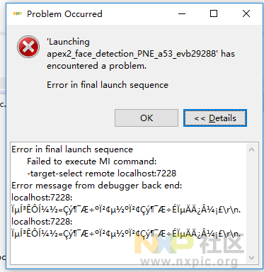

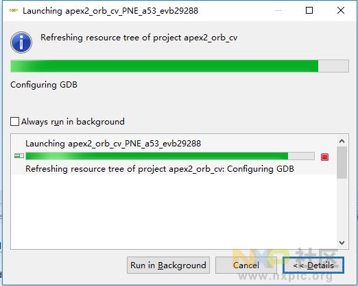

I debug the project in S32DS using P&E,but it met problem .The program is example in SDK.
as shown in picture,it stagnate in this step,and it met error as shown below
I wanna know whether I debug the A53 and APEX can only use Lauterbach.
Thanks all.

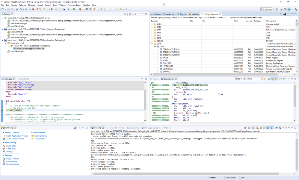

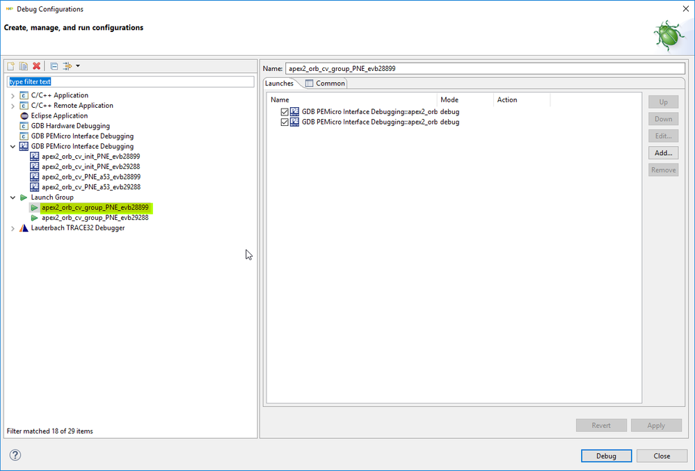

Please make sure that you don't have Linux running on your EVB (remove SD card or disable boot from eMMC). Also be sure that you are using debug launch group:
I tested the example and for me is running correctly with PE Micro Multilink FX (with limitations as mentioned by Mike):

hnxiaojuzi
      Thank you Jiri , I have solve the problem, I used to debug project with P&E universal,and I tried FX ,it debug successful.
