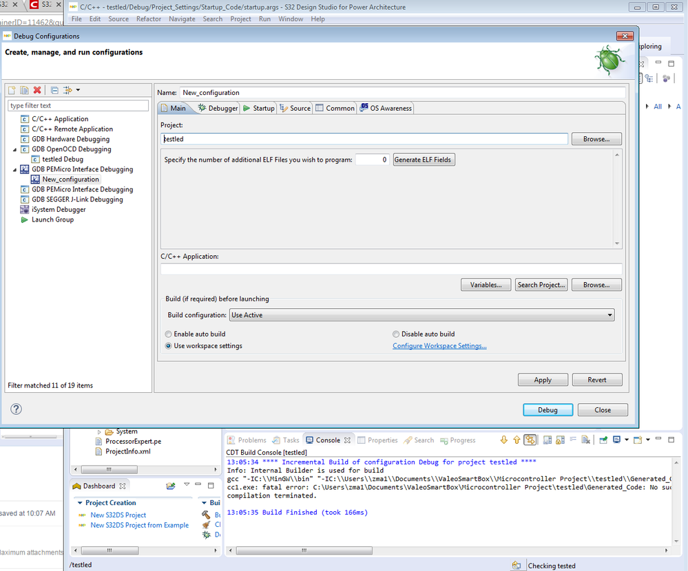

I started this with a plain computer(only has windows 7). I use to have error like"fatal error no such file or directory" and "gcc/g++ not found in the PATH". After I installed MinGW and included path and built it, I dont have problems. But when I go debug I do not have the .elf file and it shows "Program file does not exist".pastedImage_1.pngAnd here is my setting pastedImage_2.png
I have worked on this for a long time. Really tried every solution on this website and anything I could find on Google. Can someone give me some assistance. I will be much appreciated.

I suspect this project was created in Processor Expert Software, Microcontroller Driver Suite:
Processor Expert Software, Microcontroller Driver Suite|NXP
I'd recommend you to download it and import the project there.
There are many dependencies to Processor Expert plugins which are not supported by S32DS for ARM.

Also at the Debug Configuration, I could find PE micro debugger which I suppose I should use for my MCU? Do I need to install through help? Or maybe PE micro is not the right debugger?

I don't think you can use standalone Processor Expert Software to debug generated project.
The main goal of the tool is to generate C init/driver code which you can then build in any other tool like CodeWarrior.
If you manage to generate an .elf file you can program and debug it in S32 Design Studio. I'd recommend you to use option 2."Executable file importer":

Processor Expert error 2.PNGCan u take a look at this error? It asks me to contact freescale support.

it looks like that you are using S32DS for Power PC on ARM MCU. For FRDM-KEA128  board you should use S32DS for ARM ver. 1.3 desdign studio.

Thank you for your help. After I installed  S32DS for ARM ver. 1.3.I ran into some new issues."ERROR: Target processor is not selected" Which I have never ran into before using 1.2 version.pastedImage_1.png
