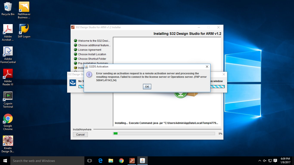

I am facing problem regarding licensing S32 Design studio v1.2. I tried online and offline activation of license code I obtained in my mail, but failed in both modes. I am unable to understand the reason for this.  For Online Activation : Inline image 1

I've checked the transactions related to your activation code and all the transactions seems ok. (there are just online method transactions) I suspect this could be caused by a firewall that might be blocking your machine to receive activation response. Please make sure you are logged as admin on your machine.
Anyway I'd recommend you to download and install newer release: S32 Design Studio for ARM v1.3 (Windows/Linux) released!
You should get a new Activation Code.
If you are still unable to install using online method please try Offline activation on S32.
Post here an error message if you get any.
Thanks!
