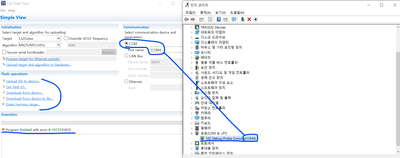

I have S32G-VNP-RDB2 and S32 Debug probe.
I try to written in flash area.
but An error has occurred as below.
Program finished with error #-1073741819.

mikedoidge
Hello Youngdae,
Before you can use the flash operations, you must 'Upload target and algorithm to hardware'. If this is successful, then the communication settings are not an issue. Then you should be able to use the flash operations. What file are you trying to upload to the device?

mikedoidge
Below are possible reasons to get error in the flash tool “Program finished with error # - 1073741819”.
Could you please confirm the following conditions?
  1. The USB connection between the PC and the target was attempted on more than one USB port.
  2. The target is set to ‘serial boot mode’ with the following:
    i.      BOOTMOD0 (SW14) = all OFF
    ii.      BOOTMOD1 (SW15) = all OFF
    iii.      BOOT_CFG[0:7] (SW6) = all OFF
    iv.      BOOT_CFG[8:15] (SW7) = all OFF
    v.      BOOT_CFG[16:23] (SW8) = all OFF
    vi.      BOOT_CFG[24:31] (SW9) = all OFF
  3. A serial connection can be established from the PC to the target using a terminal program (PuTTY, TeraTerm, etc.), this would also confirm that the USB cable is good
    • Can you flash the SD card with Linux BSP and set the board to SD card boot mode? You can find an image of Linux BSP on Flexera if you have not already have one built. Then, you can test that UART, the board, and the cable works by just turning the board on and viewing the BSP serial console on the PC. Make sure uboot and kernel both are initialized.
  4. There were no other serial connections active on the same COM port at the same time the S32 Flash Tool was in use (no terminal program running on the COM port), etc.
  5. The COM port should be entered using UPPERCASE letters. It is not likely the cause of this error, but it is what is expected by the S32 Flash Tool.
  6. None of the DIP switches are damaged.
  7. You are directly accessing the flash commands without first using 'Upload target and algorithm to hardware...'
