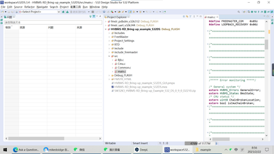

The interface of my S32DS has been modified by me as follows:
Is there any way to change the interface to the initial one at the time of installation?

Hi hanhan,
Yes.
Window->Perspective->Reset Perspective...
Robin
