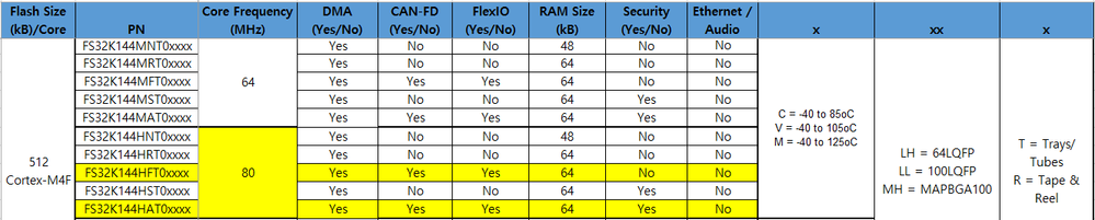

I would like to use FS32K144HFT0xxxx MCU.
The MCU's core frequency is 80MHz.
So I try to set SPLL clock to 80MHz with SKD_S32K14x_09 in S32 design studio for ARM.2018.R1
But I could not set SPLL clock to 80MHz, because of below warning.
Is it possible to set SPLL clock to 80MHz?
If it is possible, how to set 80MHz?
Thanks and best regards,
Byungju.

As your comment, SPLL frequency spec is below.
In case of FS32K144HFT0xxxx MCU, Core frequency is 80MHz.
If I set the SPLL clock of FS32K144HFT0xxxx to 90MHz, Is there any problem in operation?
Byungju.

kbj
Dear Jiri
There are F32K144UAT0VLLT MCU that core frequency is 112MHz and F32K144HRT0VLLT that core frequency is 80MHz.
Both of MCUs can set the SPLL to 90MHz?
If Core frequency is not SPLL requency, What is core frequency?

kbj
Dear Jiri,
Thanks for your reply.
I will repeat the following questions for clarification.
1. What does the Core Frequency in the EXCEL table below mean?
2. If the core frequency is the frequency of normal RUN mode, how do you set it to 80MHz? (If you set it to FIRC, it is max. 60Mhz.)
Byungju.

jiri_kral
The 80MHz in the table means that ARM core can run on 80MHz or less.
can you share your project? I'm not able set for example FIRC to 60MHz on my project. To check final values is better look at the Clock values summary page:
