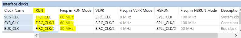

I would like to use FS32K144HFT0xxxx MCU.
The MCU's core frequency is 80MHz.
So I try to set SPLL clock to 80MHz with SKD_S32K14x_09 in S32 design studio for ARM.2018.R1
But I could not set SPLL clock to 80MHz, because of below warning.
Is it possible to set SPLL clock to 80MHz?
If it is possible, how to set 80MHz?
Thanks and best regards,
Byungju.

based on this AN - https://www.nxp.com/docs/en/application-note/AN5408.pdf  the supported range for SPLL is 90-160 MHz.
Jiri

jiri_kral
I didn't find any SPLL limitations info for HRT0VLLT variant. So - let's summarize it:
The SPLL clock source is frequency of Oscilator - for example 8MHz. SPLL output range is 90-160MHz -taken from FOSC by dividers/multipliers.
SPLL output is source for Core clock. You need to use dividers/multipliers in way to satisfy the max allowed core clock for HSRUN. That is how I understand it.
Jiri

jiri_kral
The 80MHz in the table means that ARM core can run on 80MHz or less.
can you share your project? I'm not able set for example FIRC to 60MHz on my project. To check final values is better look at the Clock values summary page:
Jiri

kbj
Dear Jiri,
Thanks for your help.
As you do, I set SYS_CLK of RUN mode to 80MHz.
Byungju.
