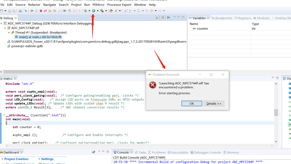

Hey, everyone. I bought a Devkit-MPC5744P recently and download the S32 design studio from the NXP website. It is OK to build an example project and debug the project with the openSDA to the devkit .
But when I click the "RUN" button, problem always occur:
lauching *.elf has encountered a problem ; error Starting Process.
"Step into " and "step over"  are available .But the project cannot be run.
I just wanna know how to run the project, thank you.

please use Debug button (one icon left next to the RUN button) instead of RUN button. The run button is not implemented.
