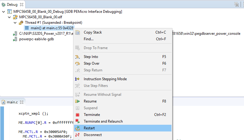

OliverTian
 You can also use mouse to get the restart.
  In 'Debug' window, right click mouse on main(), you will find the 'Restart' icon on the popped menu, as the snapshot of below.
Cheers!
Oliver
