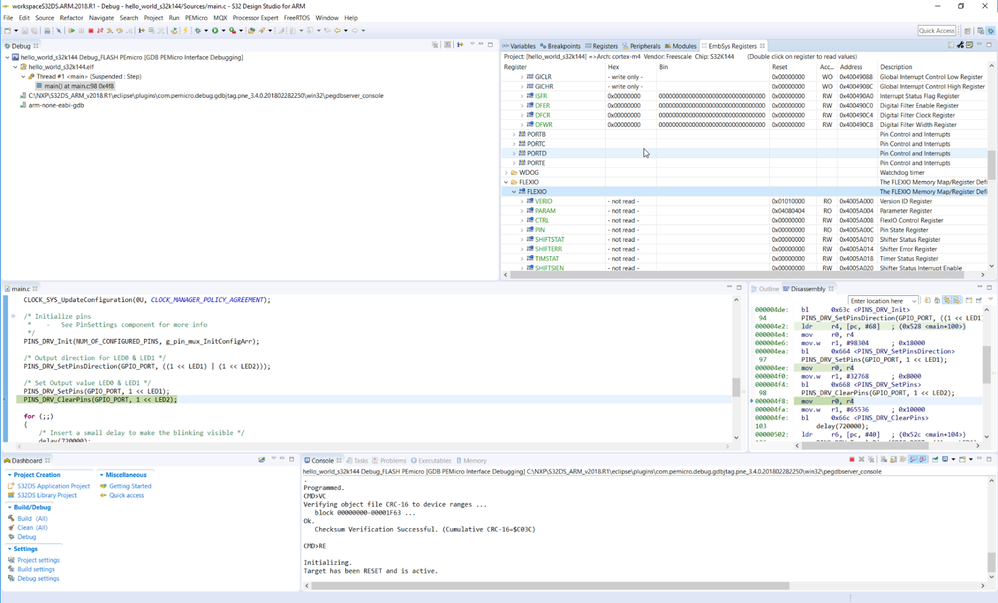

I would like to manually read/write registers while debugging.
i opened the "EmbSys Registers" window:
   menu Window > Show View > Others > Debug > EmbSys Registers
Is this what I am looking for?
double clicking on the registers wont get their values. How Do I read/write regsiters?
Thx

yes, this is the correct window. For read/write values (by double click) - make sure that your debug session is stopped Registers can't be modified when MCU is running. Some peripherals (for example FLEXIO) needs to be configured prior use (clock/pin mapping). Without correct settings can't be data read.
