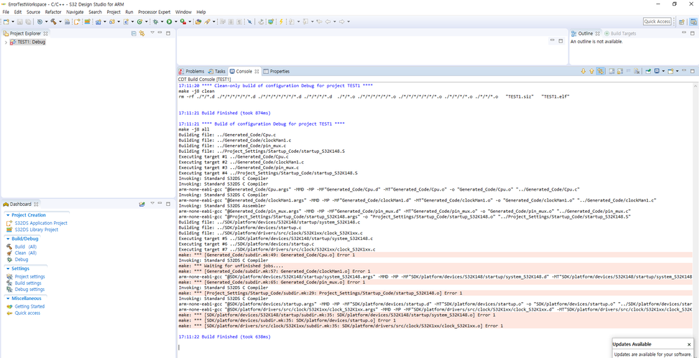

Dear.
I use S32DS for ARM 2018 with SDK 3.0.0
I reinstalled S32DS.
After create project, I didn't add any code.
But the project with the tool chain "ARM Bare-Metal 32-bit Target Binary Toolchain" occure compile error.
the project with the tool chain "Standard S32DS toolchain for ARM" does not ocuure compile error.
How to resolve it?
I attach the project and error message.
Please check it.
Byungju.

I tried import your project and there is no issue on my side and project can be build with ARM Bare-Metal 32-bit Target Binary Toolchain without any error:
You can try to use new workspace directory and import your project.
Jiri

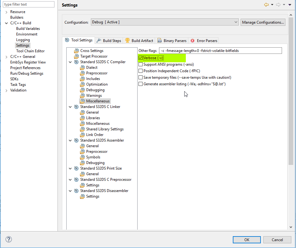

it looks that you are using SDK project - correct? Did you generated Processor Expert code properly? You can also enable verbose build mode to get more details:
Jiri
