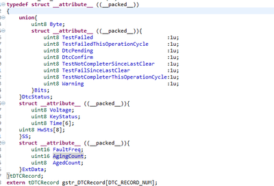

1. First I wrote a structure object like below:
2. second , create a variable by using this structure and click build,

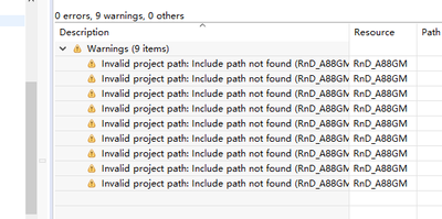

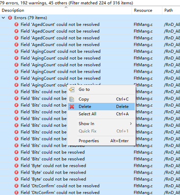

3. build process work around and *.elf file generated, but "Problems" shows errors like below:
4. That's really confused me a lot, so I try to deleted all errors and try buiding project again. This time NO such errors occurred in "Problems".
5. But those errors  reappeared in "Problems" after I open the C source file which use the structure described in the first step
No proofs point out that the structure was wrong, but why those errors about "Field XXX could not be resolved" triggered while these errors would not block the build process? thank you !

The target MCU is S32K146, Thank you also for presenting the reason for such a problem exist . Later I will check the update

jiri_kral
what's your S32DS Version and target MCU?
Earlier versions of S32DS has known issue - for some projects the build generates false positive errors. The errors was shown only in S32DS (S32DS is based on Eclipse) - but target was build successfully. In later S32DS version was this issue fixed.
