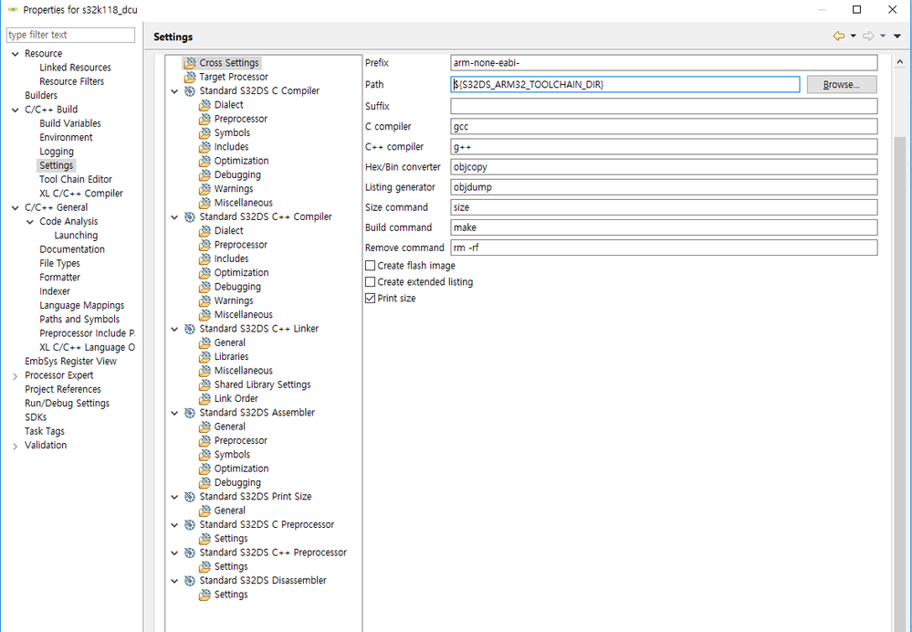

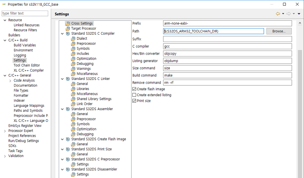

Hello. Support team.
I want to use only C compiler without C++ compiler such as A Case.
How to remove C++ compiler in 'B case' ??
A caseB case
C CompilerC Compiler + C++ Compiler
Thank you.
Best Regards.
#s32k #designstudio#c compiler#c++ compiler

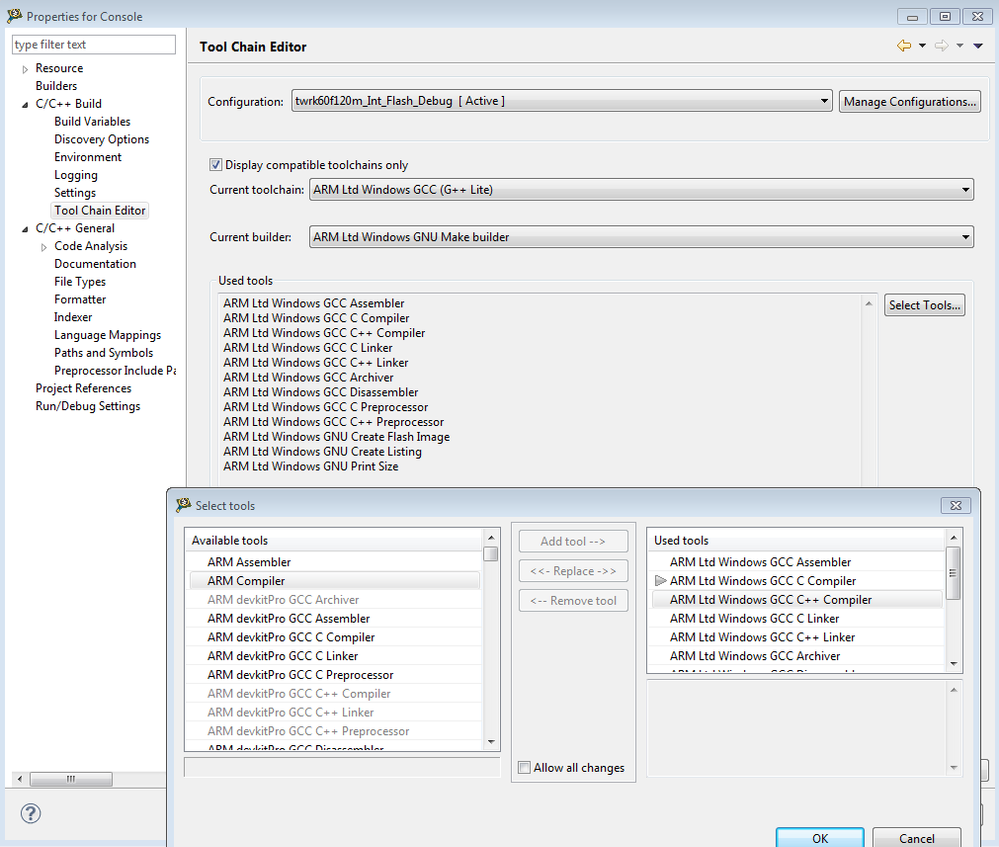

I'll add: you must check the "Allow all changes" option in order to remove tools (like the C++ compiler, etc)
2,654 Views
danielchen
Hi:
I would suggest you use the Tool Chain Editor, please see below picture.
