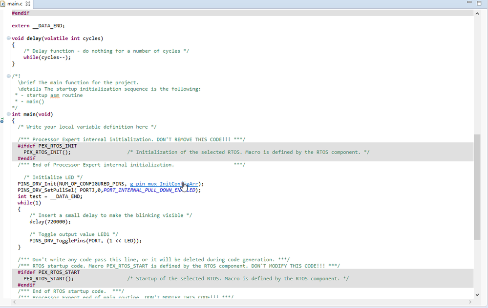

I'm a newcomer to the processor expert (S32 ds for power) that generated codes are so complex(Structures have a deeper level of nesting),so how can i understanding the meaning and structure of the Program code that Automatic generated as soon as possible.
Could you please give me some advice or methods about this.

I'm not sure if you are aware about this eclipse feature - just move mouse cursor to structure you are interested in, press CTRL key and double click on name. The source code for that particular structure/function will open in new tab:
But you know - any complex stuff need extensive effort to understand it.
