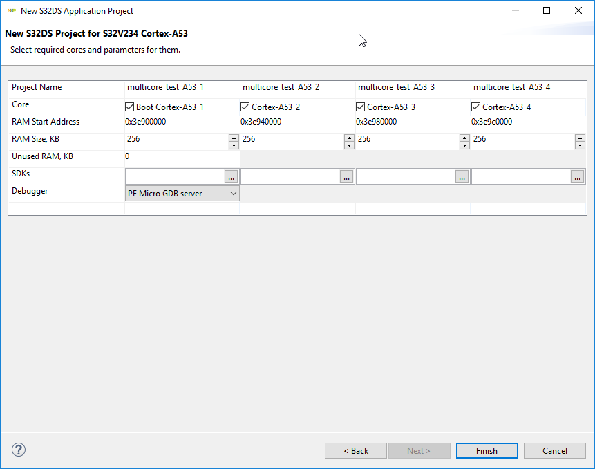

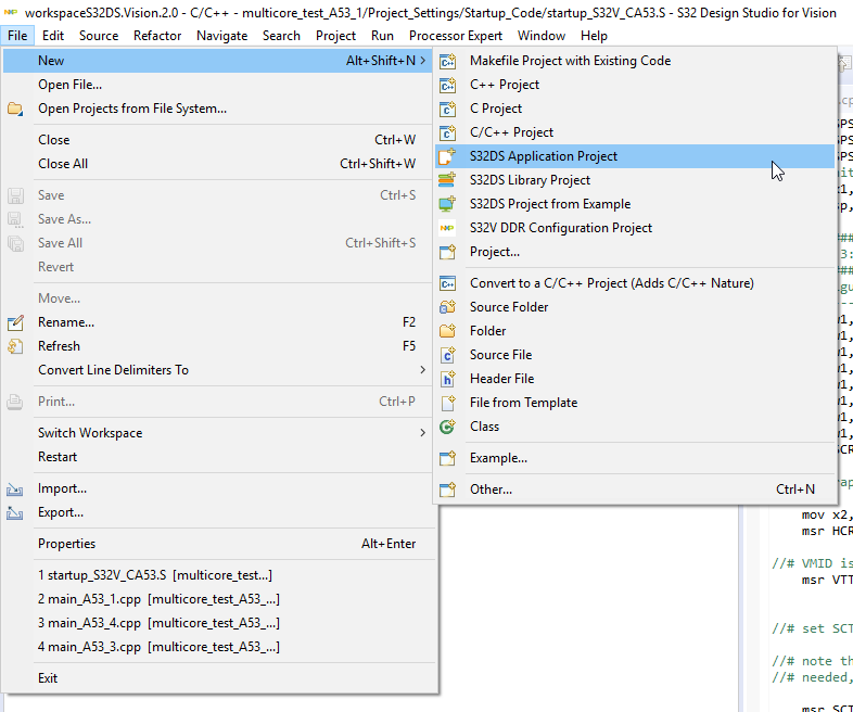

Technically multicore project for S32V234  baremetal target are 4 elfs - each for one core. It is up to you how you solve core to core messages/flags/critical sections/shared memory. Here is simple example (for Power PC, but the principle is same across platforms) for shared memory: Example S32R274 multi-core shared memory - S32DS Power v1.2
Easiest way how to start is create new application project, select your MCU
You can modify RAM size/addresses for each core or disable cores:
And you can start with experiments.
