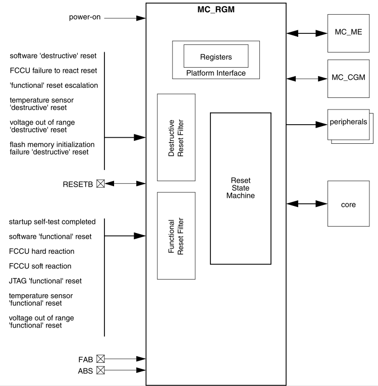

martin_kovar
the behavior you describe about IVOR1 exception is correct. If you do Power On reset, ECC errors are created in RAM and if you read part of memory where the ECC error is created, you will get IVOR1 exception.
In general, all resets which are destructive, does not retain content of the RAM memory. Functional resets retain RAM content.
So, after Power On reset, you must initialize the RAM you will use.

stanish
I'm just wondering why you need to go to the bootloader via reset. What kind of reset are you using?
Perhaps you could branch to the bootloader from your app instead. You can e.g. find a reset vector (rchw) = bootloader entry point in the memory and then perform absolute branch to that address - this should not generate any ECC error in RAM.
Now in the bootloader startup you can test if a reset has occurred (you can e.g. clear all reset module flags before jumping into the bootloader address). If there is no reset flag set you can skip RAM initialization routine and the content of RAM keeps unchanged for further processing by the bootloader.
