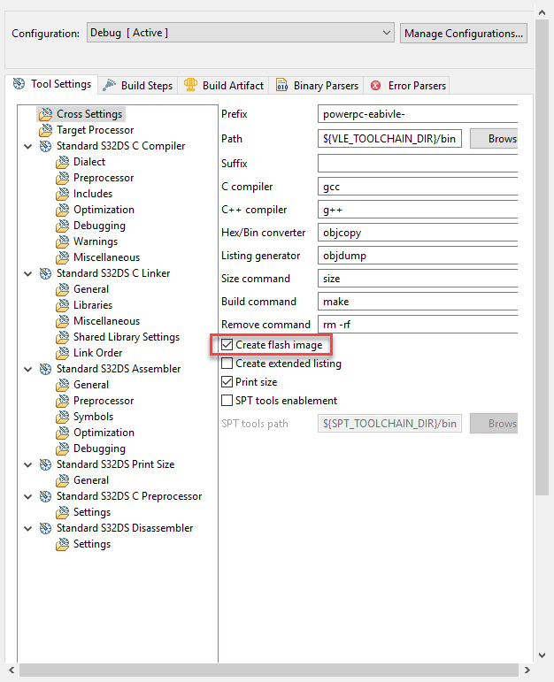

yangyulong
How can I get a mot file or s19 file by the s32d for powerarchitecture
Tags (2)
2,739 Views
martin_kovar

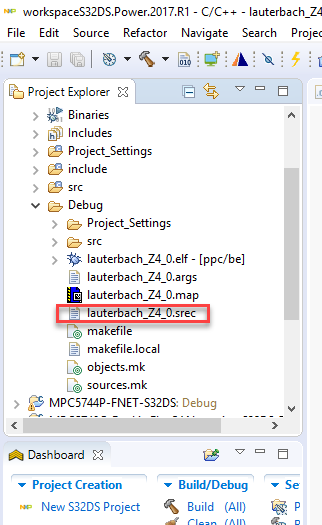

please open project properties and click Create flash image
Click OK and recompile the project. Now, you should see srec file in Debug folder.
Martin
