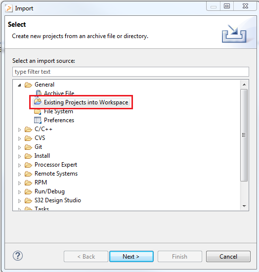

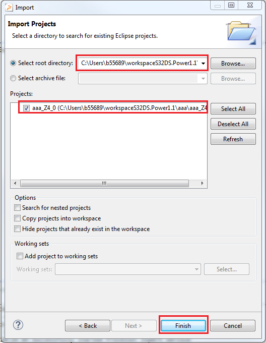

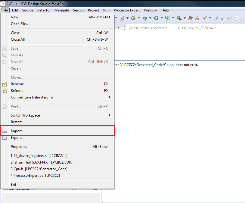

open S32 Design Studio and click File->Import
Select General folder and choose Existing Projects into Workspace
Choose path to your project and click finish
Hope it helps.
