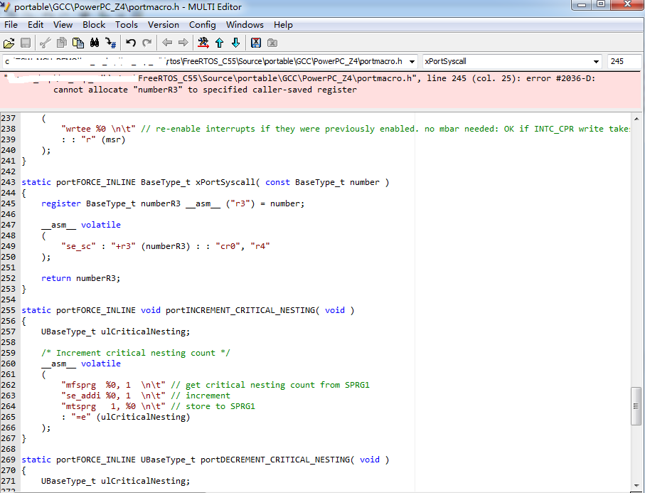

I have a question about compiling the FreeRTOS code of MPC574XG  in GHS MULTI IDE.
With GNU C mode enabled and enable the option "-gnu_asm_se_vle_register", most of the asm compile errors disappeared. Unfortunately there is one error existing such as " cannot allocate "numberR3" to specified caller-saved register".
Could you give me some advice how to fix the error in GHS MULTI compiler ?

Thank you for your advice. The "accept gnu __asm__ statements" option have already enabled, but ghs compiler also reported error.
And I try to change r3 to another register, the error still exists.
I try to remove  "__asm__("r3") " in the code and it can work. Will the modification impact stability of freertos?
Of course, I will also contact GHS.

Have you enabled "accept gnu __asm__ statements" option?
Can you try to use any other register e.g. r24 instead of r3 -  just to check the compiler accepts it?
Anyway I'd recommend you to contact GHS support for more information about GHS compiler details.
