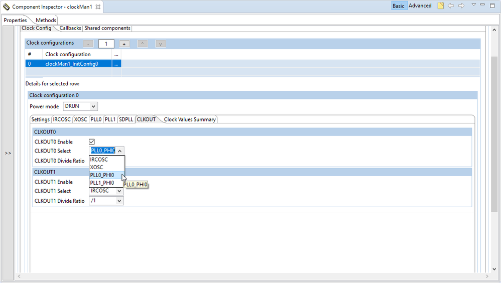

Hello!
First explain that the chip I used is S32R274,the IDE is S32 Design Studio for Power 2017 R1.
I set the system clock at 120MHz,and try two ways,one is open the PLL1 fraction function,another is closed.At two situation,I use the I/O toggle to test,find the speed of toggling is equal.And then I set the system clock to be 60MHz,the speed of toggling is a half.
To get the real number of the system clock,I try to read the CMU register,because it has a function for metering the frequence,but just for the IRC.
So!!! How can I get the real system clock?Read the register or use the oscilloscope.
Thank you!

the easiest way is enable clock out and use oscilloscope:
Jiri

Hello,Jiri.
This is a easiest way to solve the problem,it may be that I don't clear my meaning,I just have the daughter board of the EVB board,I can not measure the CLK_OUT pin.Do you have other methods?
Thank for your help!
