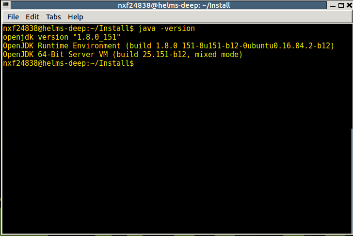

jiri_kral
is Java 1.8 installed on your machine? You can check it by java - version command.
Jiri

anandakella
Hi Jiri,
Java home is already installed in the ubuntu docker container.
root@f94b41130810:/s32_nxp# java -version
java version "1.8.0_161"
Java(TM) SE Runtime Environment (build 1.8.0_161-b12)
Java HotSpot(TM) 64-Bit Server VM (build 25.161-b12, mixed mode)
Anand

jiri_kral
Hi Anand,
I spoke with installer team - and I'm sorry - the console/silent mode is not supported. It is default part of Flexera InstallAnywhere software - but not implemented in S32DS installer.
I'll rise defect ticket - in my opinion options which aren't supported should not be an usable option.
Jiri
