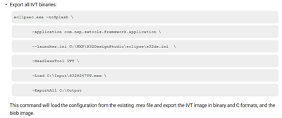

Your IVT image file is likely correct. The IVT image file only contains the IVT data, that is, the header information of pointers to each of the IVT component images, but not the application bootloader data or any of the other IVT component images. If all this was included, then we would call it Blob file.
In your command, I'm not sure why you perform the IVT image import. This is not needed. The information needed to generate the Blob file is contained within the .mex file. When you use the option to import the IVT image, all the data provided by the .mex file is cleared and only the data coming from the IVT image is loaded. So then you no longer have the application boot image (or any other IVT component image files, if any exist). There is likely some error message reported (listed after 'SEVERE') indicating that the Blob generation option was skipped.
My suggestion is to use the 'ExportAll' option to generate all of the binaries as shown in the user guide.
